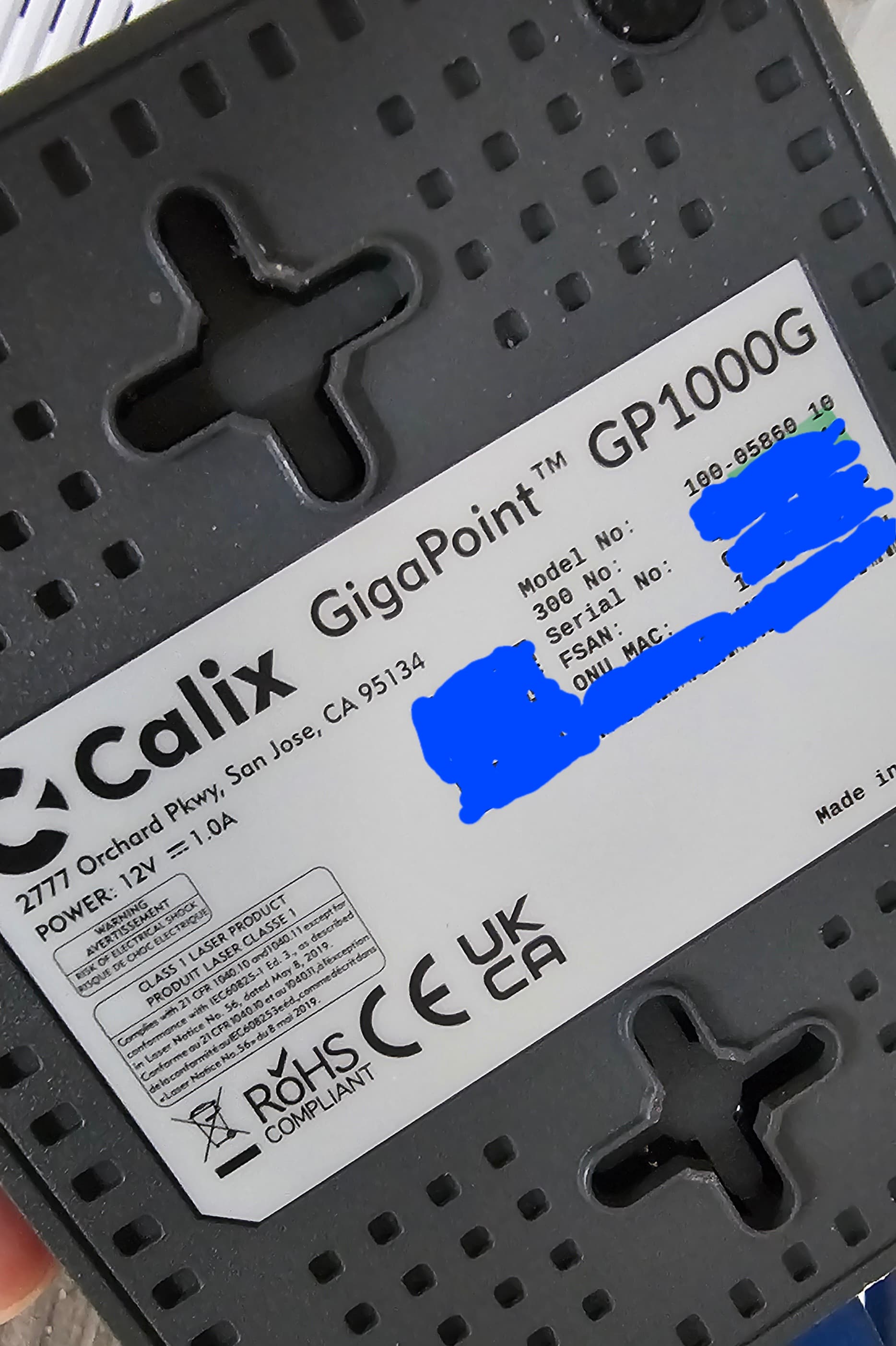

That’s interesting as I got mine upgraded to support multigig but I’m not sure which model it is - I can’t seem to easily get it off the wall and I don’t want to knacker it. The pictures of the 1000G and 1100X look pretty similar but I’m thinking mine looks a bit more like the 1000G which would be a bit mad if the upgrade needed an upgrade!
I think @Yayzi_Team have the power to interrogate the ONT so you could probably ask them. In fact, I’m going to ask the question too - @Yayzi_Team can you please advise what model ONT I currently have?
That’s what I thought but there’s no movement at all and I don’t want to use too much force. Maybe they glued it to the wall!!

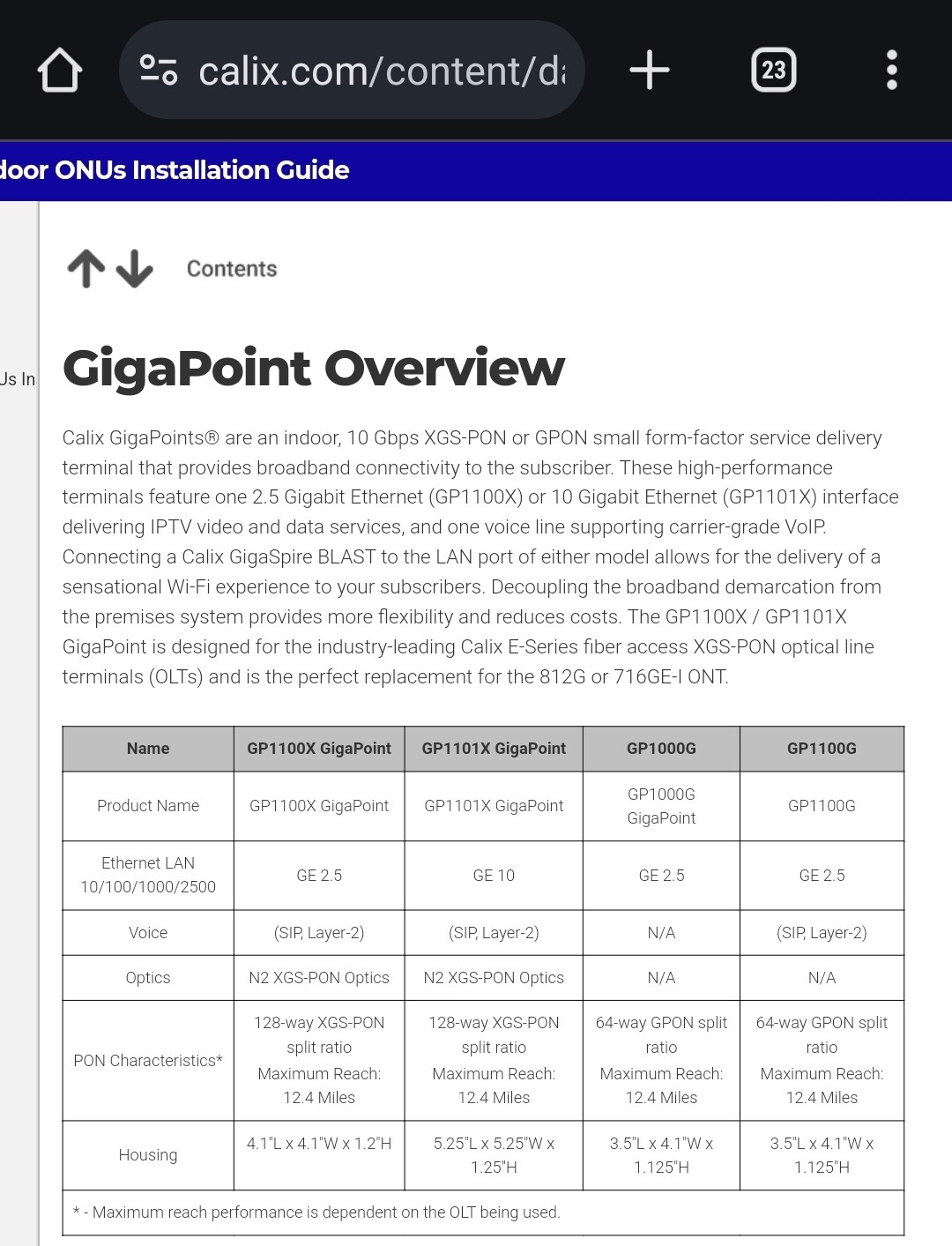

According to Calix’s website the 1000G has a 2.5gbps nic. Weird if it only supported up to 2gbps throughput.

Hmm, according to those measurements then, I either have a 1000G or a 1100G. If that doesn’t support the full 2.5Gb up and down, then I’m a bit surprised they replaced my previous one with this model if it’s still old hat and can’t handle the full speeds.
Depends on which Network Cityfibre have built oout in your area. GPON areas get 2.5Gbps Down 1.2 Gbps Up
newer rollouts and upgrades will see the shift to XGS-PON 10gbs/10gbs.
This is pretty bang on, GPON ONTs only have a 2.5Gb port, but the XGS-PON ONT will have a 10Gb port.
