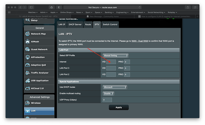

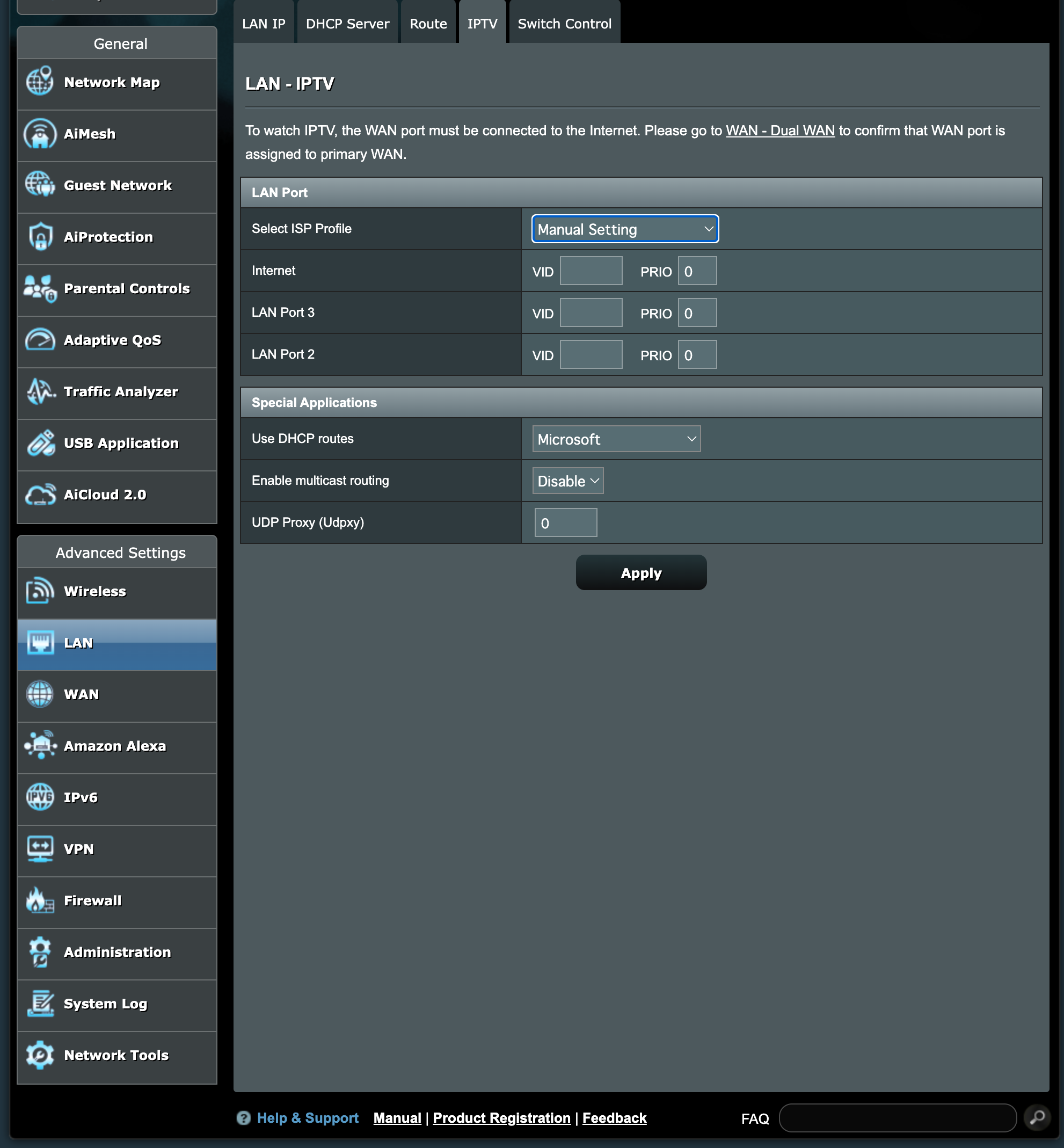

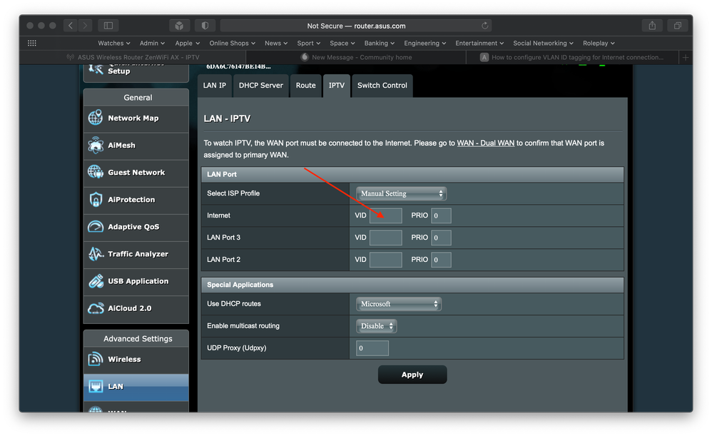

Do you have an option similar to this in the webgui?
If the model doesnt support vlan 911 on the wan interface, then it wont work directly into the ONT. It may work having it run behind the Yayzi supplied router, but risk running double nat if the Asus doesnt support AP only mode.
Yes it does.
Fill the internet box in with 911. You may need to wait 15-20 minutes for the connection to come back up. Id reboot the ONT after 20 minutes with your Asus plugged directly into the ONT. That should work.
ISP profile should be set to DHCP not manual ( if it gives you the option)
