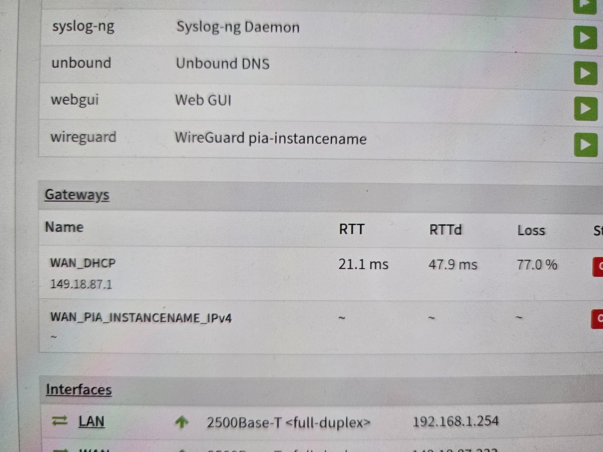

Connection has been dropping for the last ten minutes as of 8pm. Anyone else having the same issue?

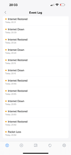

Yes I have no internet at all at moment I’m in Cleckheaton ( west Yorkshire)

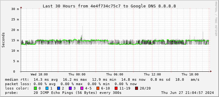

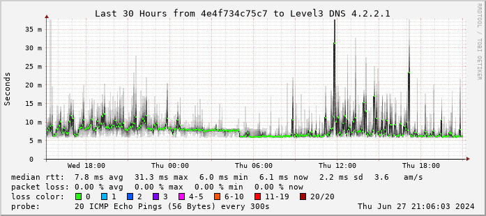

ICMP within the Yayzi network seems fine for me, so no evidence of a CF issue:
Connectivity to Google and Level3 seems fine:

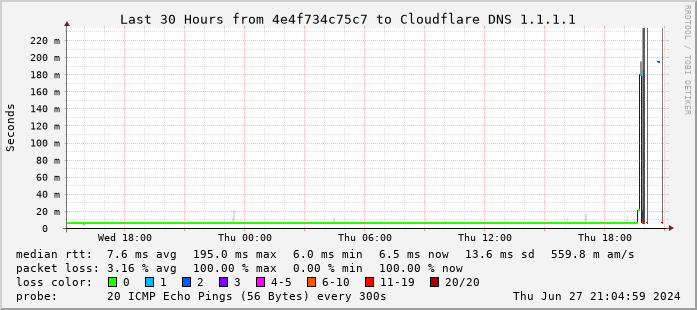

However, definitely an issue reaching CloudFlare:
Cloudflare themselves report no issues:

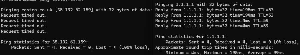

Pinging 1.1.1.1 with 32 bytes of data:
Reply from 1.1.1.1: bytes=32 time=196ms TTL=52
Reply from 1.1.1.1: bytes=32 time=195ms TTL=52

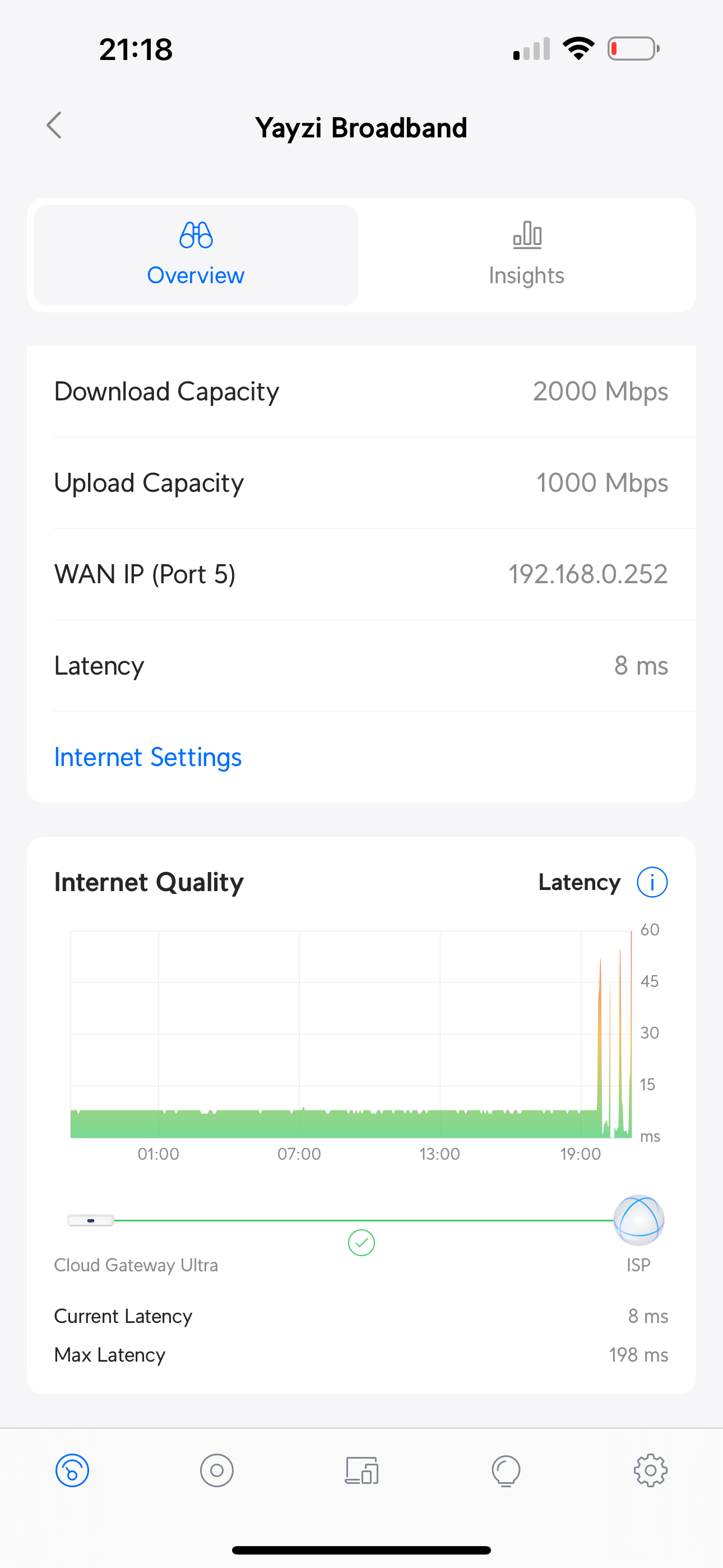

So, probably some peering/routing issue.
Traffic looks to be going through the US to CloudFlare, too, based on latency and tracert
I’m back online but ping is 195ms so as above definitely a routing issue

When the connection drops it’s now completely dropped off again but still 4 green lights on ONT
