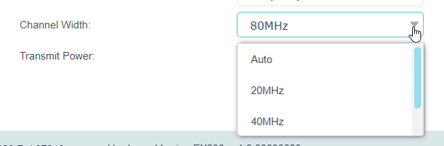

Any update on this? Here is a screenshot of my choice of wifi channel width.
It goes auto, 20, 40, 80.
For some reason I cant screenshot the 80 option but that is the bottom of the list, no 160 is available.
And if you drag the little blue line down they don’t show then?

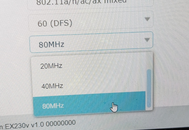

No like I said the screenshotting goes funny when I try to scroll the list to the bottom, but here is a photo to prove it only goes down to 80.
Change your channel for 60DFS to Auto and see what that does
Makes no difference.
80Mhz is the highest option available.
And channel 128 is the highest channel available.
The UK allows channels 132-144 and 149-173.

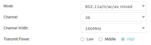

My router is the EX820v supplied by Yayzi and I did briefly experiment with 160Mhz, but found it would only stick as a configuration if I selected channel 36.
The problem is that it gobbles up all the bandwidth from channel 36 to 64 and due to interference from other local users I had to abandon.
I found that a lower bandwidth was much more reliable in practice.
Perhaps if I was located somewhere much more rural then using 8x 20Mhz channels might be fine without upsetting neigbours.
