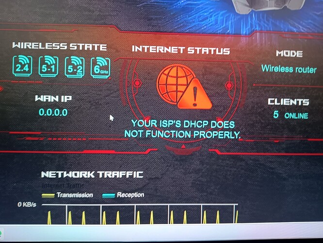

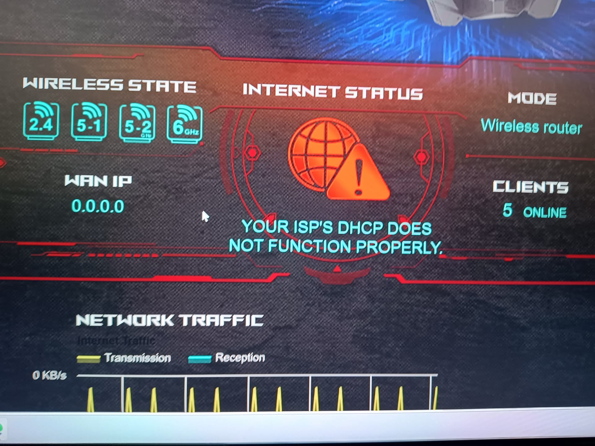

ISP's DHCP Server does not function properly
I reset factory reset my ASUS router, I’ve put everything back as it was. But I’m still getting this error.
I need information
When I set it to static it connected but no internet
Static up details as follows
IPAddress : not disclosing
Sunnet masc: 255.255.255.192
Gateway : 79.135.101.129
Vlan:911 prio: 0
This connects saying it connected to the internet however none of my devices have an ethernet connection?

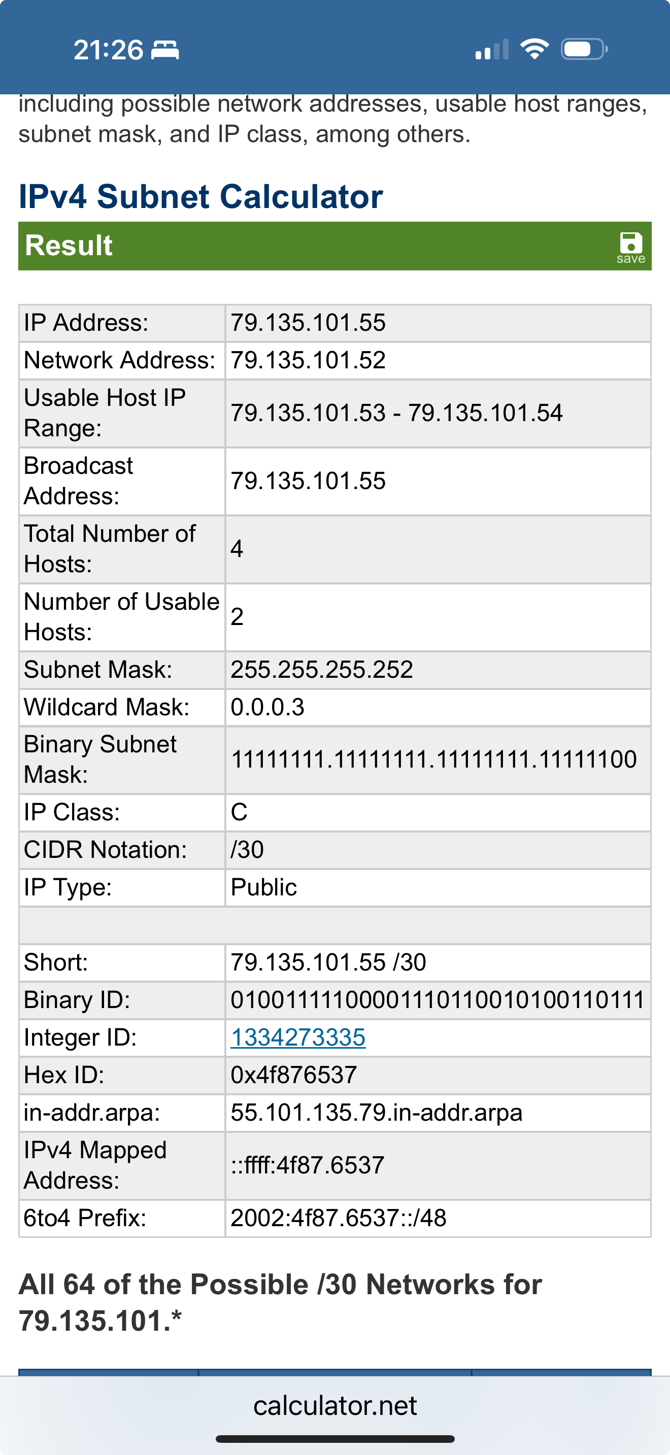

I thought you put your IP address as the gateway address, so I’ve put that back as you didn’t actually disclose your IP address as I mistakenly thought you did
I will check against mine as I am on the same subnet
My set up unfortunately does not show me, what the subnet mask should be. Perhaps @WhyAydan will know as he has access to the backend at least a little bit.
That is a big subnet for 1 IP. Where did you get this from?
Scrolling through this help forum I’ve been at this for hours I’ve tried everything I’ve found so far
I just used a number from that range and it came back with this, but again it could be entirely wrong
