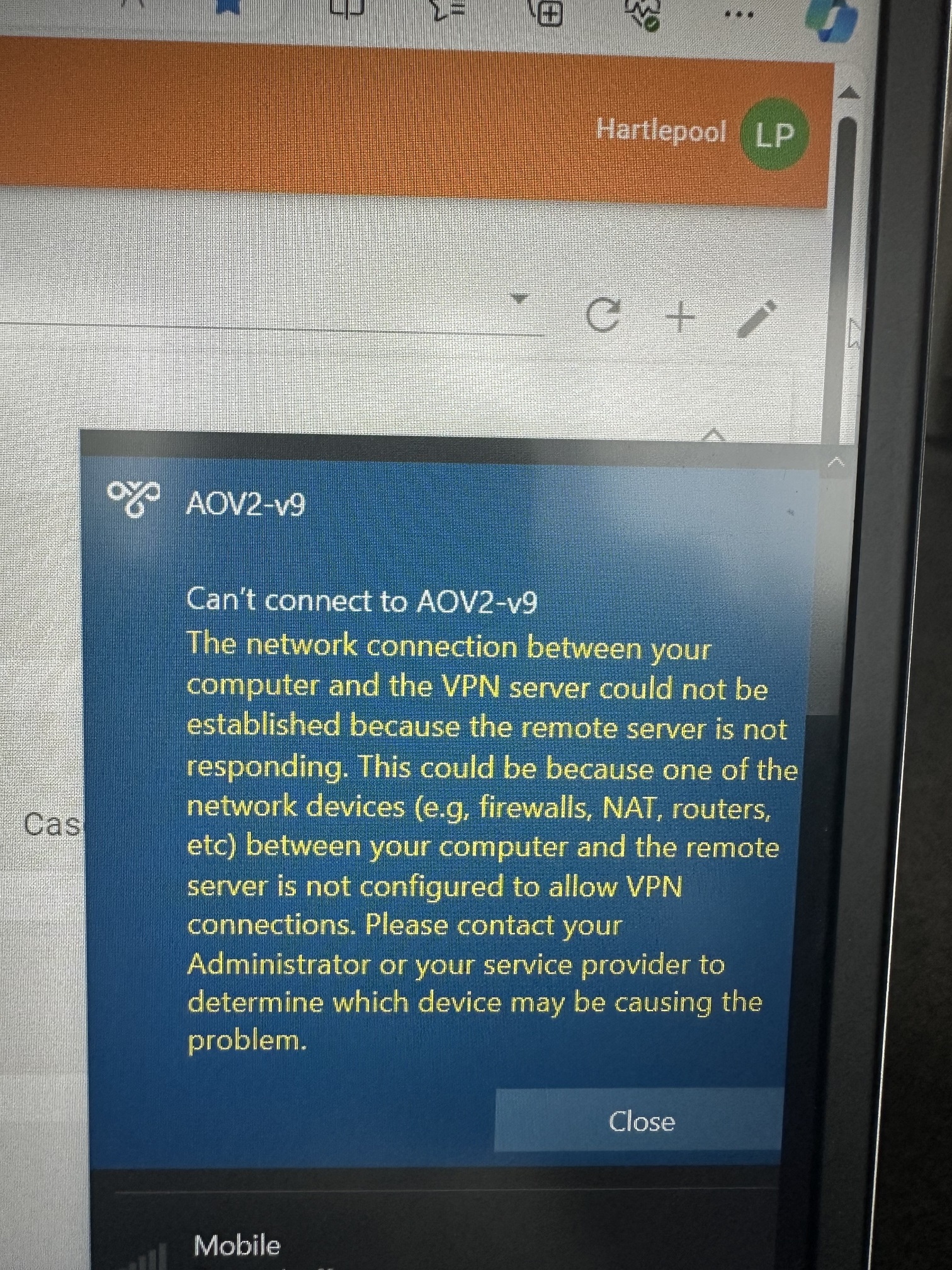

Hi my partner is tying to work from home and she is getting this on her works laptop. She never had this issue with virgin media and it always worked so it must be an issue with Yayzi or the router.
Yes and no. Technically it’s her work’s VPN server that isn’t responding, but the reason why it’s not responding is likely because of the geo-location database issue that’s been widely discussed. Her IT department should be able to confirm both my logic and which database(s) they check against and then Yayzi can request an update to the relevant database(s), at which point it should work.

Ok they have had a look and saying the VPN which they use is being blocked by Yayzi. The below message is what her works have told her.
The VPN that we use to connect to work is being blocked. Works on other networks but not working on home internet. Is there anyway they can unblock the VPN for work
