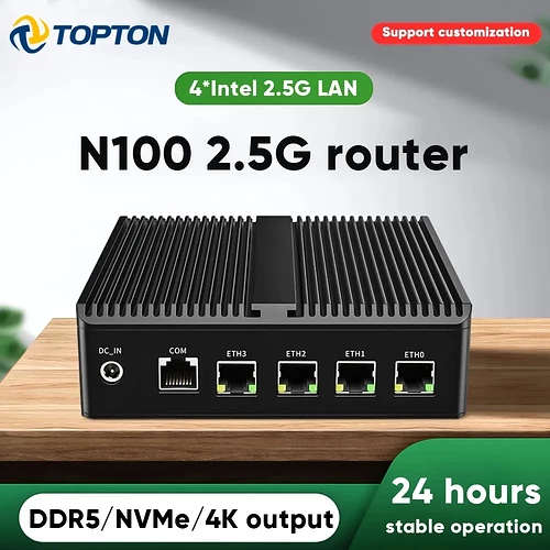

Intel Nuc 4x2.5GB/s Lan N100 with PFsense.
Nice one I will take a look thank you.
Router wise the supplied HX220 on the gigabit packages is surprisingly not awful, I normally run Untangle or OPNSense, but for basic functionality, I actually quite like the TP-Link kit. 2.5Gb gets a little more interesting though, the cheapest option is the Yayzi supplied router at £99, after that it’s something like the Flint2 running OpenWRT, the SMB TP-Link stuff is twice the price and usually brings you into the Omada ecosystem (think Ubiquiti Unifi but not for posers). You can of course go with a Topton box - can we please stop calling them NUC’s as they are not a NUC just because they are small - but you’re then looking at OPN/Untangle/OWRT/IPFire anyway and adding wifi yourself. The catch is you ideally want the newer i226, but support on some of those is not available, so i225 rev c. becomes the next best choice bare metal. As long as the router OS supports WAN VLAN tagging, it’ll work though, and if it doesn’t, then workarounds exist (Proxmox tagging VLAN 911 on virtual interfaces for example).

I have one of the N100 NUCs as well (from Aliexpress) - works perfectly; significant upgrade from my old Celeron J1900 based NUC, hopefully it lasts just as long too.
It feeds a bunch of 2.5Gb+10Gb SFP no-name switches which are also surprisingly good (I am sure that a branded switch would have far greater backplane bandwidth but I’m not dropping £500 per switch to get it!) and they power and feed a number of Unifi APs around the house for coverage. I will say that if I wanted outright speed, Unifi wouldn’t be the way I’d go for APs but, again, you’re spending several times the money to get faster 4x4 MIMO or greater APs.
