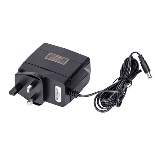

But I don’t want to pull out the power supply and cable of the ONT (it is in an awkward location. Can anyone tell me that the voltage is of the ONT power supply and what tip is used?

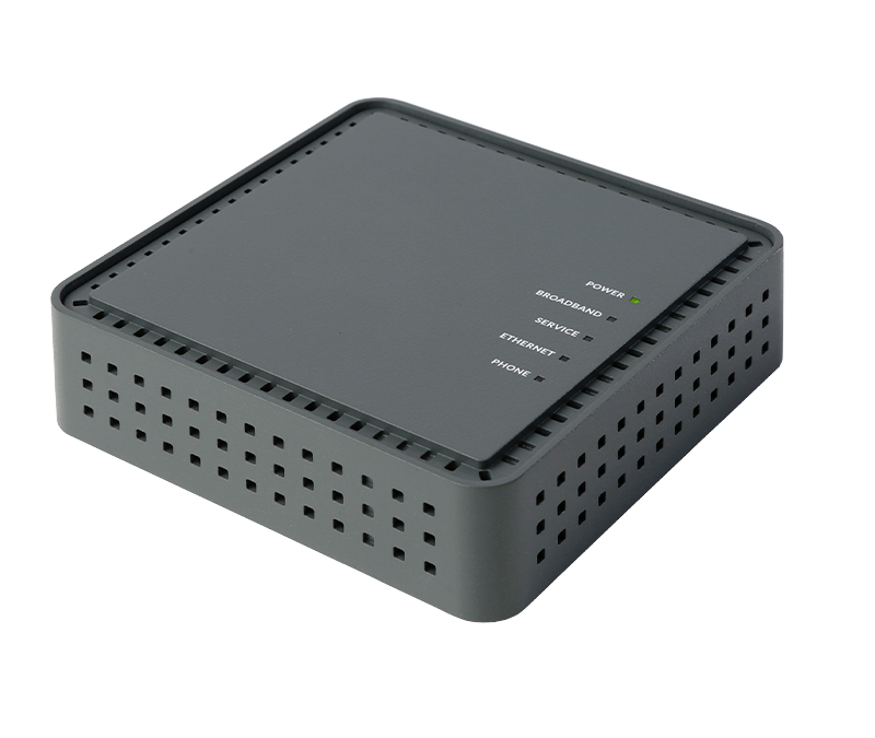

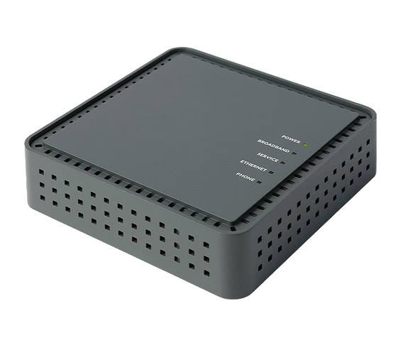

My ONT looks like the calix one:
Here is mine for a Calix GP1007x (I think)
I have a Calix 801G which is 5.5 x 2.2mm
Think the 1000 series ont has a smaller 5 x 2.1mm DC Power Plug
