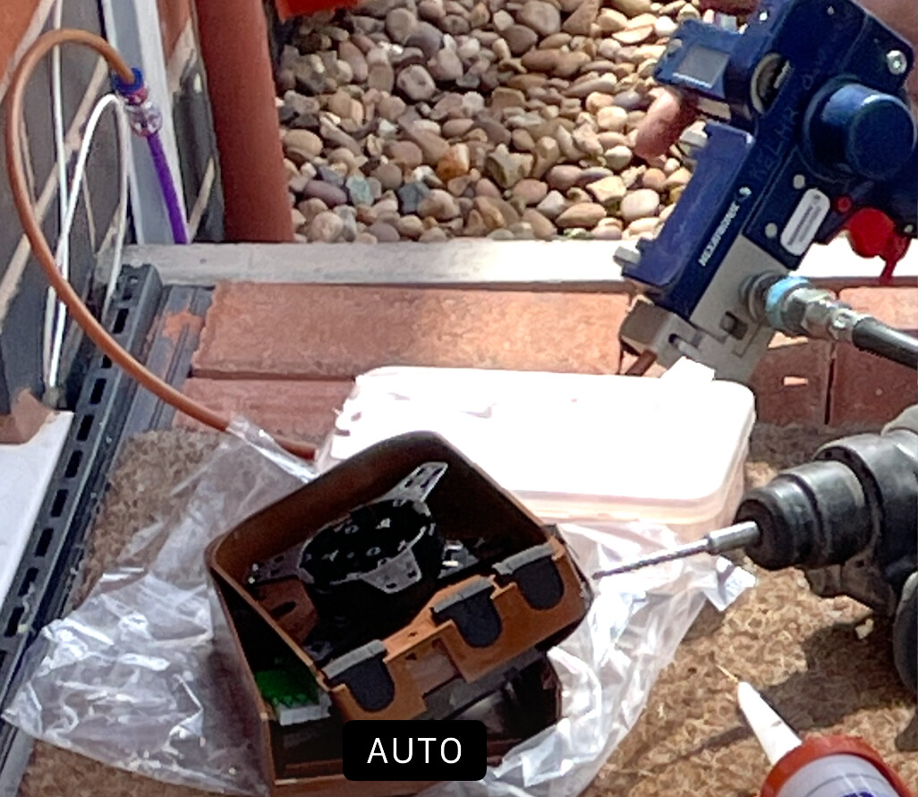

Hi there, yes you can do this, and the engineer will be more than happy for you to do that, the ducting they pull is 7mm micro ducting and is brown.
The ducting can bend but is easily crushed under heavy objects like slabs/concrete blocks.
The ducting can bend for example in a 180 arc with a span of 80cm-100cm so does have a lot of flexibility but does like to bend back on itself!
It’s a great idea overall to place your own conduit in before the engineer arrives, just let the engineer know what you’re doing.
Any questions let me know, I have worked on the city fibre contract for numerous years now & here because I’m finally installing it into my own house!

The conduit Cityfibre run is 7mm iirc, purple underground then coupled to a brown cable above ground to the Fibre Connection box.
Mines underground from a green box up the road, shared with Openreach duct.
If you install your own use something like 20mm flexible conduit.
Flexible conduit has grooves and ridges in it, it may prove hard to pull through a fibre cable over a distance as it will probably get snagged in the grooves. I would go for something smooth if you can.
You can get smooth bore flexible conduit.
https://flex-it.co.uk/flexible-conduits/non-metallic/a-series-pvc-spiral-reinforced/
Cityfibre push through the purple conduit from the your house to the Green Box. The fibre is blown through the purple conduit.
If you run your own conduit for the internal run then a drawstring and a smooth bore conduit are needed.

I ran ducting from a hole I drilled in the exterior wall, through beneath my wooden floor to a central location. The install didnt go well, CF pulled my pull cord all the way out and then claimed it “snapped” (it was intact still). My suggestion would be to watch the install closely. Theyre probably not used to doing anything non-standard, but were happy for me to crack on and do it for them.
My termination in the brown external box is just a SC/APC coupler, so you can absolutely replace the internal cable run post-install
