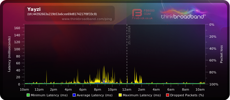

Using freshtomato here, and seriously line is as clean as a whistle. What other things do you have on your network?, perhaps check there also. Check CPU load on router etc.

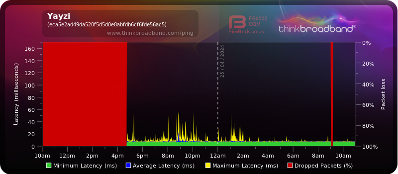

Here’s my line using an Ubiquiti Cloud Gateway Ultra
Ignore the big red block - @WhyAydan helped me setup ICMP replies
The other red line was loss of power (also intentional)
