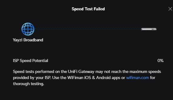

Just joined Yayzi yesterday and my UDM-Pro’s speedtest is failing both manual/automatic speedtests through the web portal - anyone else experience this with Yayzi (was working fine with my previous provider TalkTalk/Cityfibre):
UDM Speedtest Failed

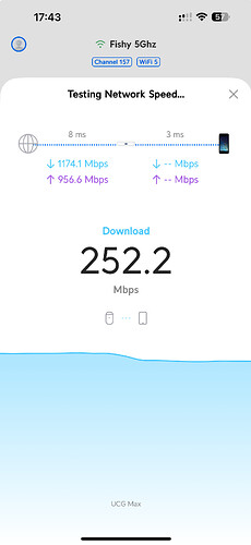

Oddly through the Unifi app the speedtest works fine and is reporting the full 1.2gbps

Am getting 890mb down and 926 up on a PC with a 1GB ethernet (waiting for the 2.5GB switch to come) with a 4ms ping on wifiman.com. Think Unifi mobile app runs it directly on the UDM as it pulls the full 1.2gig, just not directly on the web portal which is strange

Opening the Legacy GUI in settings, the Speedtest works from there, so does appear to be a Ubiquiti issue, will post on their forums to see if anyone has any ideas

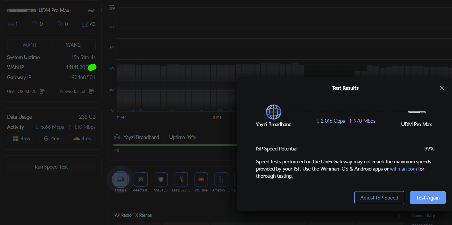

Works fine here. Enable early access updates and give it a spin.
It runs directly from the router first, then the device next
We’ll need to get your IP changed. You’re on a range that’s being taken offline due to the issues you’ve already experienced :slightly_smiling_face:
Ok, do you know when this will change? As will need to change a couple of things that use a fixed IP from my side (some backups I use)
Yes it works under the “Advanced Test”, will have to take it up on the UI forums as have spotted a few posts with people saying when they changed ISP this happens, but couldnt find a fix.
