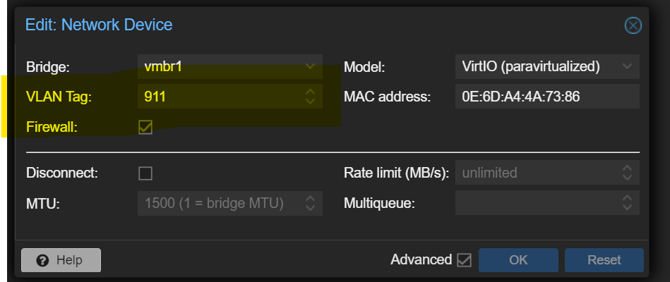

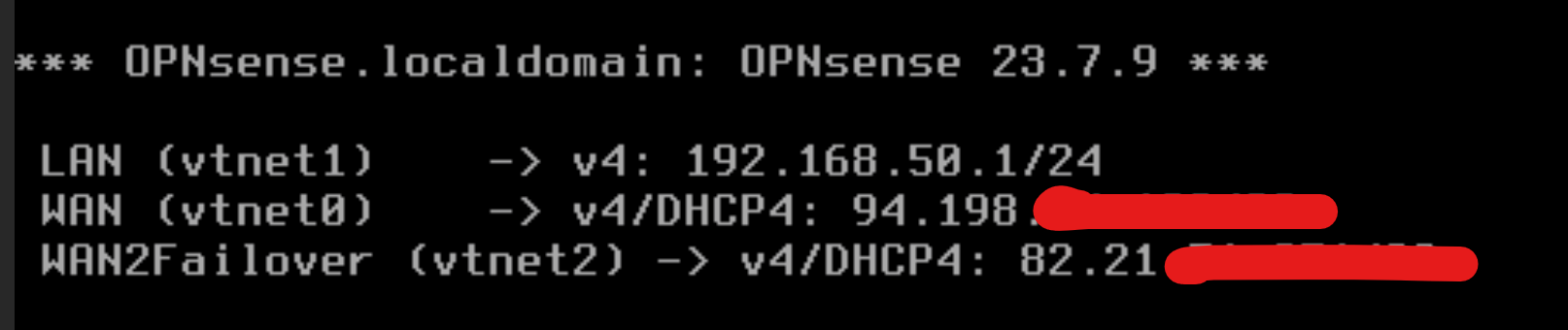

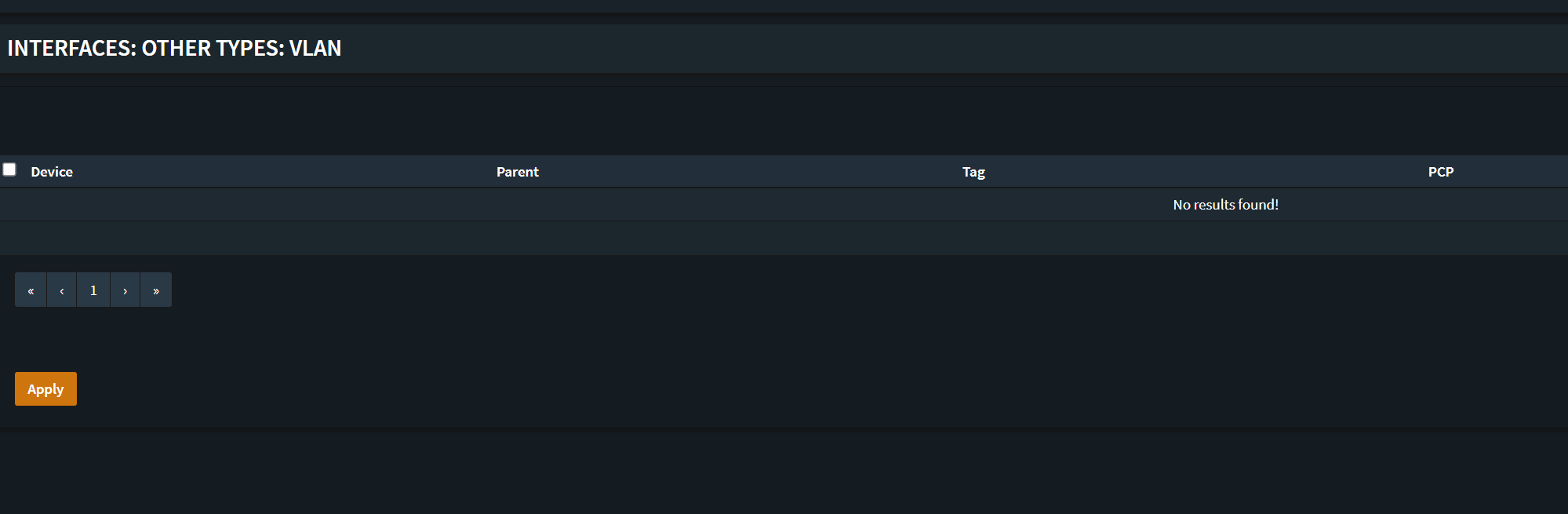

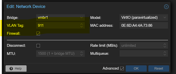

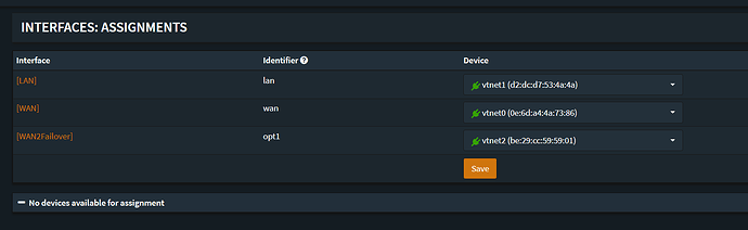

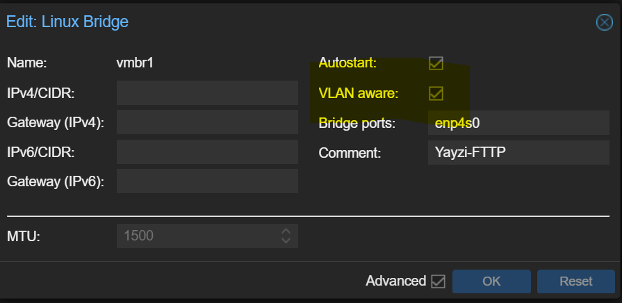

In the end I didn’t create any vlans in OPNsense. Proxmox had a issue where it was not VLAN aware on the Linux bridge until the proxmox host was rebooted. Even after the settings were applied apparently!
From there I tagged the interface bridge connected to the ONT on 911

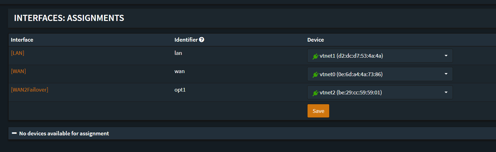

As you can see no VLANS in Opnsense

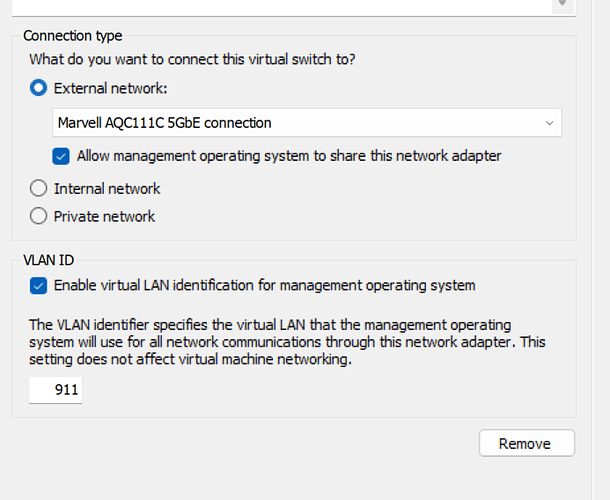

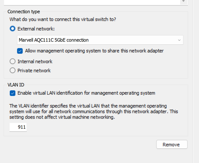

So for Hyper-V i’d remove the WAN VLAN you have created in OPNsense and set the WAN interface back to just the NIC, as I have in my screenshot.
Then in Hyper-V go to virtual switch manager select your NIC that is connected to ONT, enable VLAN and tag it on 911 like below. Reboot OPNsense and it should pull the DHCP address straight away.
In the end this isn’t a FreeBSD issue or a Yayzi issue, its a virtualisation config issue and the intricacies that go with it. Lessons learnt.
Let me know if it works, if not, i’m more than happy to set this up on my Hyper-V host and replicate it and see if I can find where the issue is. I know just how frustrating the issue can be!
Hi Lee,
Damn, didn’t even think of that which is a bit nuts as I have had to do something similar with my Sophos UTM VM to get VLANs piped through it from my L3 switches. Too many moving parts!!!
Thank you very much though - just keeping the standard WAN connection as-is on Opnsense (which is normally connecting to VM), and adding the VLAN tag to the virtual NIC as part of the host config and can now connect to Yayzi. Nice one.
