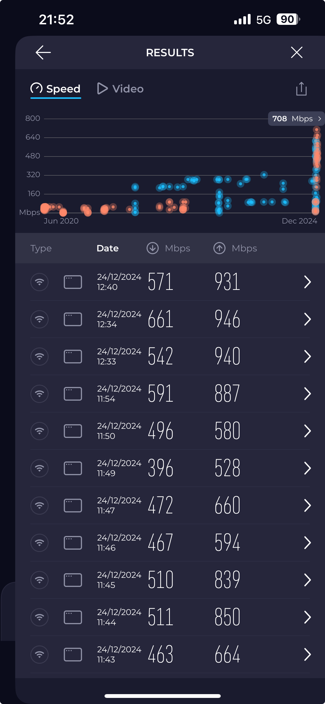

  • I used a Dell laptop.
  • My router (TPLINK BE550) is connected directly to ONT with Cat8. From its 2.5Gbps ports to a laptop with Cat6A. I don’t use Yayzi Router.
@L0rdVerga yes m8, it sucks. I have a 1.2 Gbps package.
No m8, I have never used Yayzi router. I asked them that I’ll use my own router and they did not send it to me when I switch to Yayzi.

internet is unstable so sometime I get fast WiFi speeds and sometimes very low. The problem is that I should not get unstable low speeds on wired tests. I added all these additional information to my open case on Yayzi portal. They said network team will check it out.
That 945 Mbps is upload data on laptop (wired).

  • I bought brand new CAT8, 6A cables
  • I received Tp Link AE1500
  • I checked the speeds via Tp-Link BE550 and then AE1500. It is the same.
  • I believe problem is on Yayzi because I can reach up to 900 Mbps upload speeds but download speeds on wired connections are below 600 Mbps. They are also very unstable. I checked those speeds almost back to back.

@Yayzi_Team Thanks. I have an open case ID atm. Liam responded on 23 Dec and he said “This is being look at as a matter of urgency by our network team.” I hope it’s solved soon. Thanks much.
