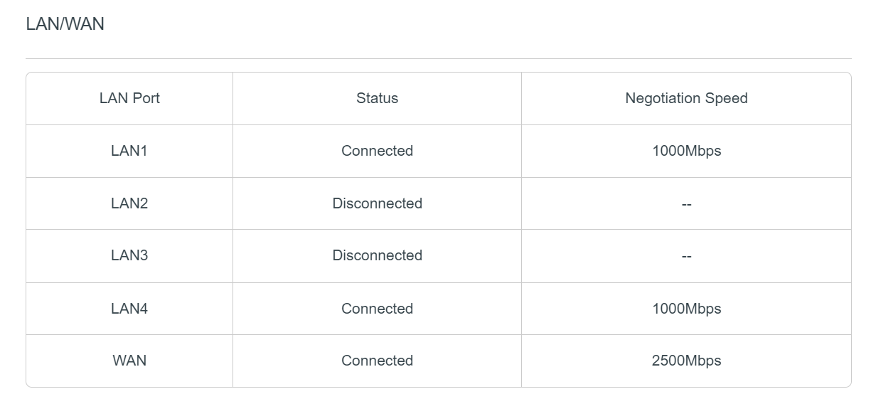

I have also ordered for 2Gig Pro+ and I was given TP Link Aginet! I can see this router is not capable to hanlde more than 1000Mb! Therefore I am geting about ~850Mb. I also supposed to get static IP but no luck!

If you’re on a 2Gig Pro+ you will get a TPLink Aginet router, it should be an EX820v.
Can you confirm that your pc/desktop has a 2.5Gbps port?
Edit: I’ve just had a look and can see you have the EX820v so definitely a 2.5Gbps router, but your WAN port is synced at 1000Mbps. Which is why you’re not getting the full speeds. You may need to check the cable, it could be faulty.
I can also see that the devices you have/had plugged in are themselves only syncing at 1000Mbps.
Check the cable, my EX820v shipped with a Cat5e cable, I switched it to Cat7 to be on the safe side.
Also, make sure you’re plugged into the 2.5g port as below, the other ports are gigabit only.
I also got a TP-Link EX820v
One interesting thing was that I tried to get the 2500Mbps LAN port working with my desktop PC’s 2500Mbps NIC, but could only get it to negotiate at 1000Mbps, until the WAN port was running at 2500Mbps, then the LAN port also did. This was when I was getting the router ready before my connection was installed by CityFibre. When it was, everything started working at 2500Mbps

I am not getting more than 1000Mbps! I chnaged all of cables to Cat8 and still no luck!
What speed is your network card that you’re wired to?
Go to your NIC card properties and firstly put it in auto negotiate, if that doesn’t work try forcing 2.5g full duplex.
it should look like this, if you don’t see 2.5g or faster then your NIC card may be your bottleneck.
The WAN port is also negotiating 1Gig so that would cap throughput regardless of the LAN side (which is also negotiating 1Gig)… @bashet do you know which ONT CF fitted on install?
I was just about to post, I changed my NIC to negotiate at 1gb and got the below
The fact your WAN says 1000mb makes me think your ONT is a 1gb is the issue.
The ONT should just gently lift if you push upwards as it’s only hooked onto two screws, you can then take a pic of the back of it to confirm the model.
This is what CityFiber installed at my home. I don’t know what type of ONT it is. If this is causing issue to get restricted to 1Gig then @Yayzi_Team should contact CityFiber to change it.

That looks like one of the 1Gb ones to me - I used to have one like that which got swapped out.
2.5Gbps ONT’s are also the same as this, best thing to do is send a picture of the back of the ONT.
