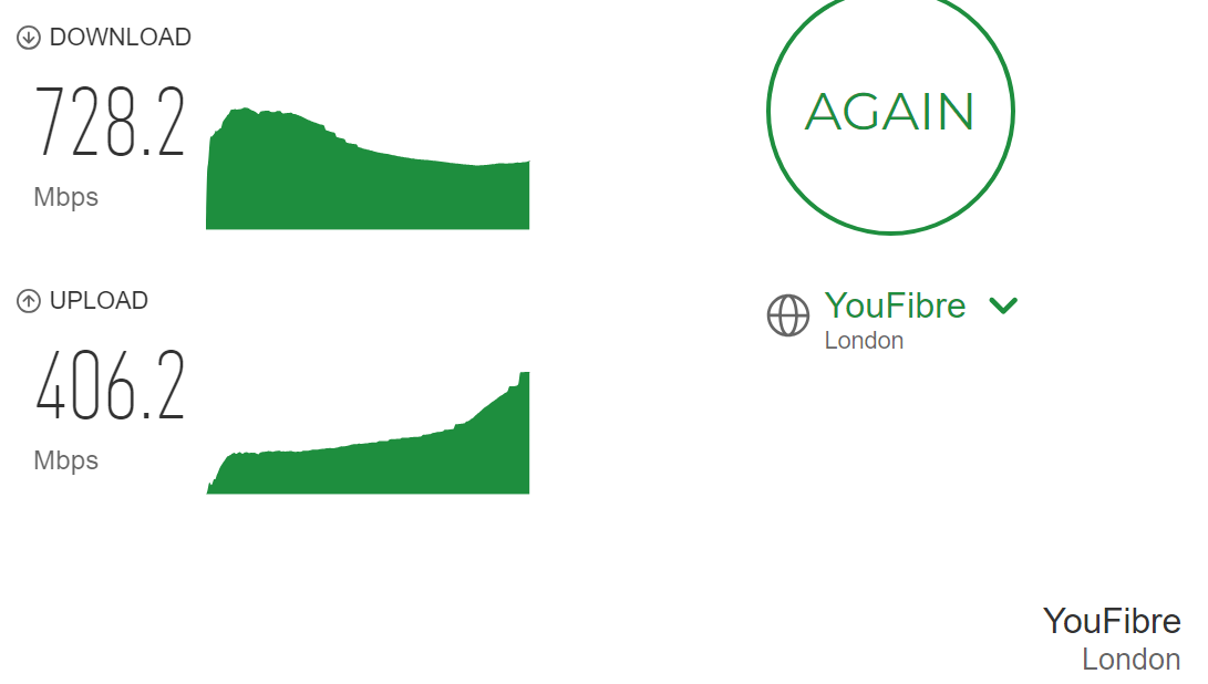

Static. Same DNS for both Yayzi and VM. Fine with VM, laggy with Yayzi. Speeds in general look a bit iffy tonight though:

As much as that definitely does seem iffy. Latency is king for gaming, don’t really need much speed for the actual gaming experience.
