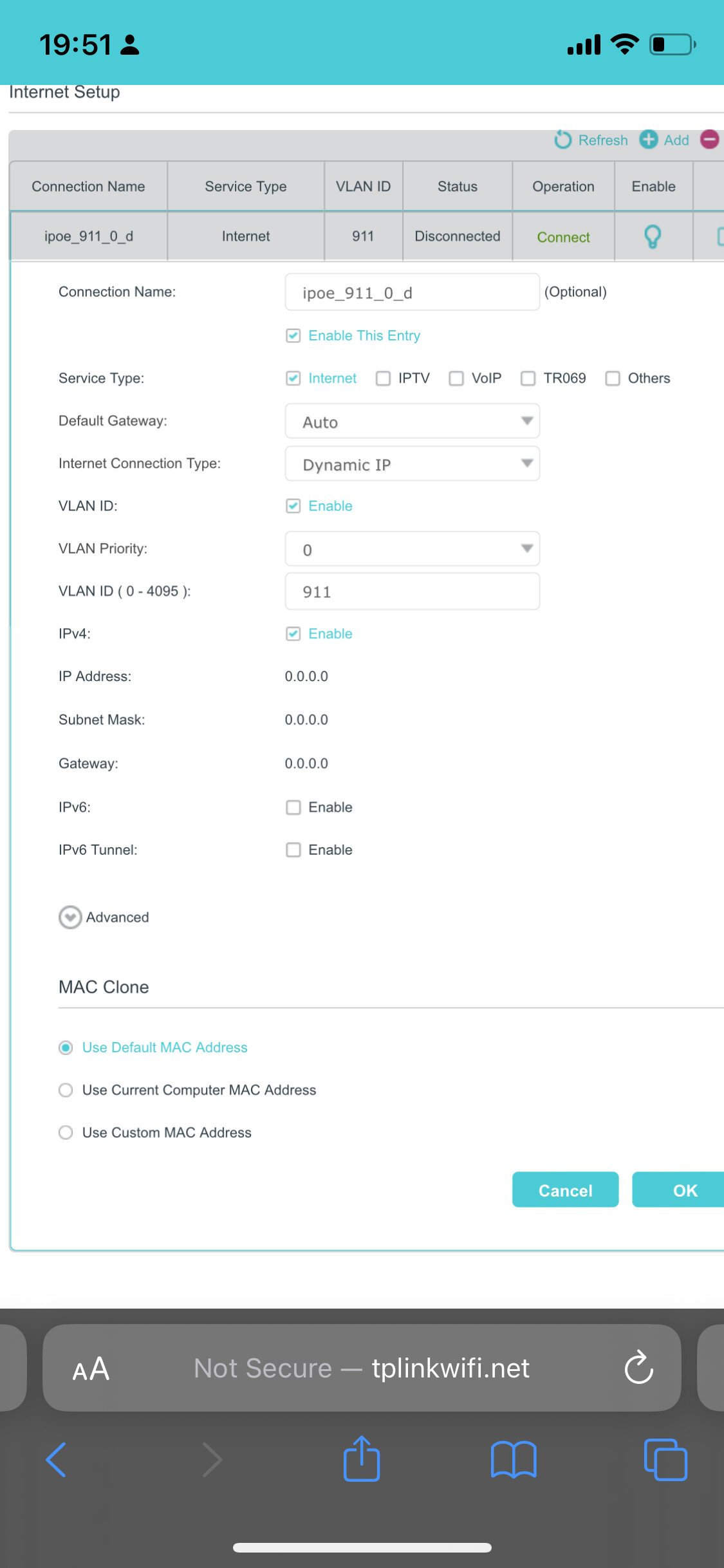

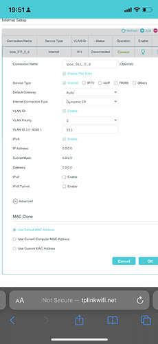

Not sure if it helps, but these are my settings currently.

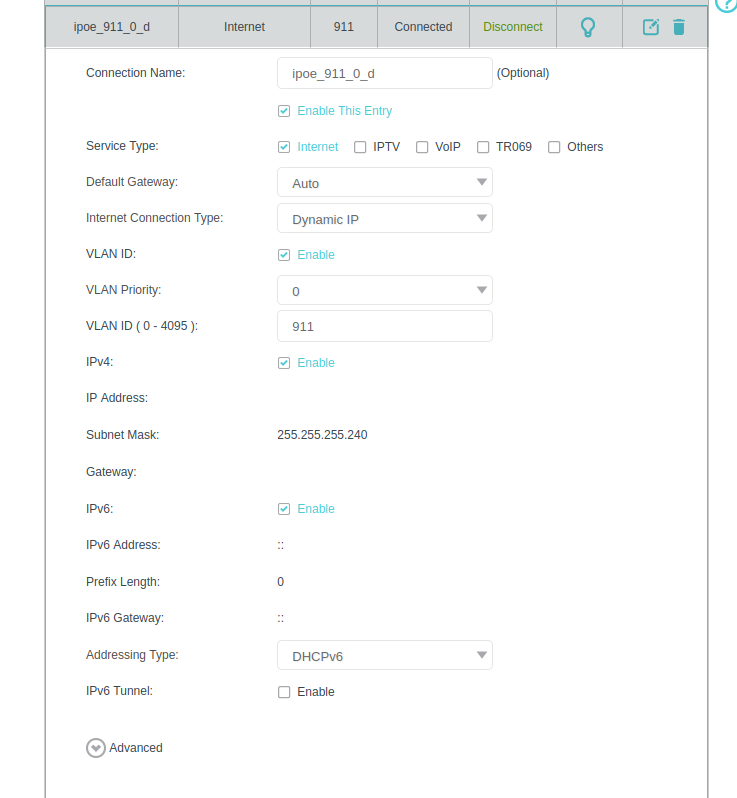

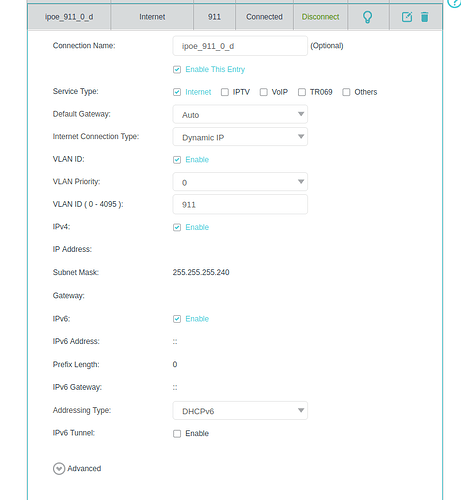

Make sure those settings match up with the screenshot. I’ve heard the VLAN ID being 911 doesn’t always matter, but you never know. :man_shrugging:
I believe that it doesn’t matter which router you use as long as it support VLAN tagging on Tag 911 otherwise you may not get an IP address, @Sean make sure that your settings match that of the image above from @doubled, VLAN tag 911 and dynamic IP (even if you are paying for a static IP).

Only slight difference is IPv6 is unchecked. I enabled it just before this screenshot in case it was a very strange bug but it made no difference. Then did another ordered reset: powered off the router first just in case there was any weird interference, disconnected WAN, reset ONT, reset the router, connected WAN… still the same issue.
Received an IP address OFFER from DHCP, but when the router sent back a REQUEST for that IP, it receives no response, so remains with 0.0.0.0. On the odd occasion the REQUEST is answered, the IP gets assigned for the 600s lease but still does not have any connectivity.
(Yea I’ve pressed the “Connect” button next to the connection entry many times lol)
