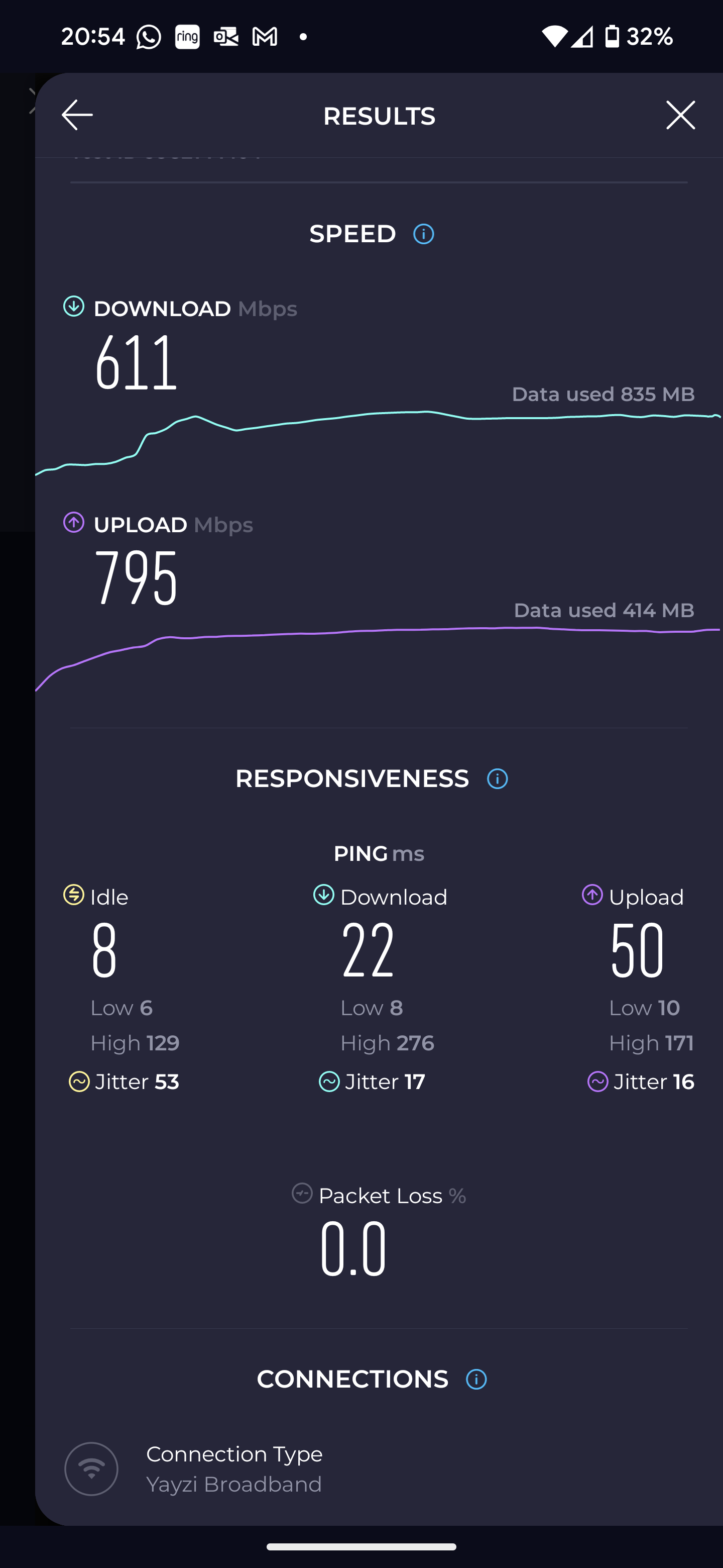

Good Evening, I’m on a 185 ip (service started yesterday). Everything seems generally OK other than BBC iPlayer randomly re-buffering.
Happy to assist where possible.
Was tested on WiFi next to router.
