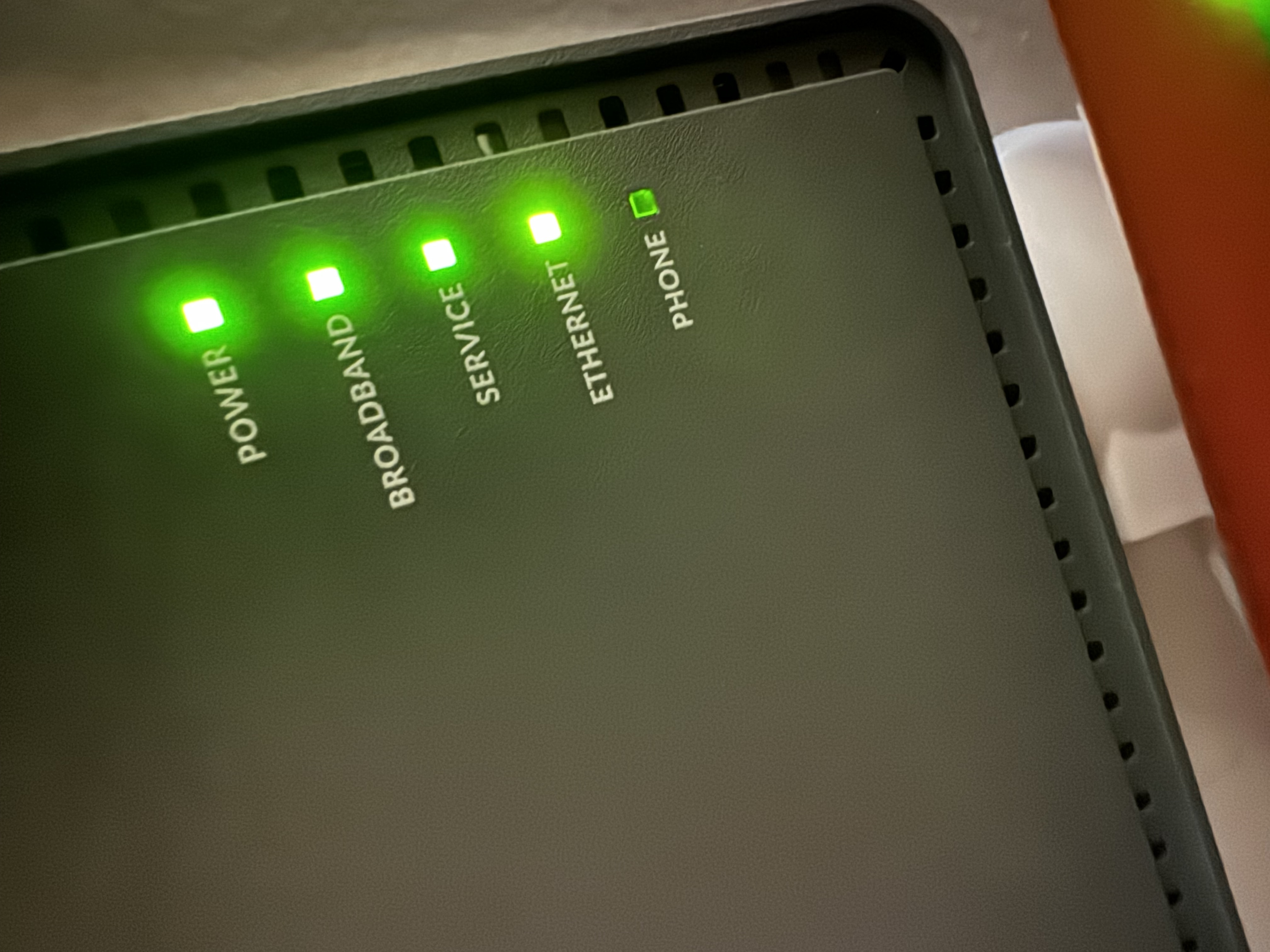

Out of curiosity, what lights are on your ONT?
All 4
