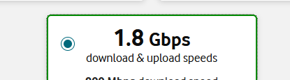

Package availability results from Vodafone for my address:
Again, this should not be possible if I’m in a GPON area, would you agree to that fact?

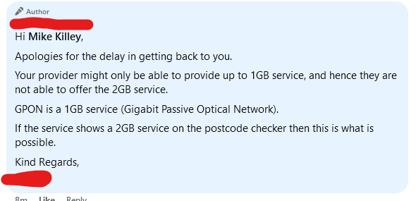

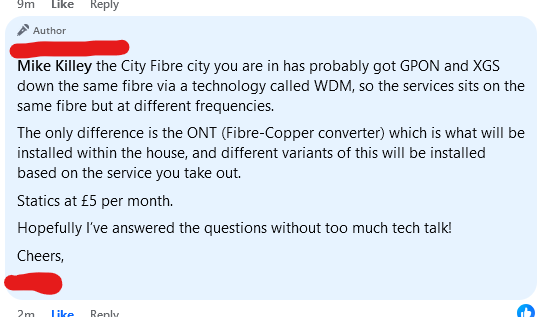

UPDATE: just got this reply from [other provider] which is now meaning things make more sense:
This is starting to go a little over my head reading from WDM-PON vs GPON vs XG-PON | FS Community, but it does seem to indicate that it’s not a clear cut as being either in a purely GPON or XGS-PON area - there is an in-between that allows for faster (and symmetrical) speeds. And what Yayzi doesn’t do yet is cater for this.
Yayzi don’t have to cater for it. They don’t care about the tech on the line between CityFibre and You. All they tell CityFibre is the max speed they can do. Which is the max that CityFibre can do 2.3/2.3. So I’m really not sure why other providers are saying false info. They should be polling the exact same API endpoint.
